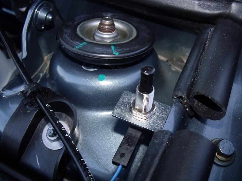

My alarm was going off for no obvious reason. I checked all the doors and windows were properly closed but the problem persisted. I checked under the bonnet next and found the 'plunger' switch was stuck and therefore not being pushed down when the bonnet was closed. Sorted by a spray of WD40 (l hope!).
If you've got an alarm as fitted with the 'Protection Pack' It might be worth you lubricating your switch too.

I had the same problem went back and had new switch under warranty at dealers
