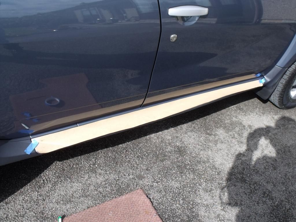

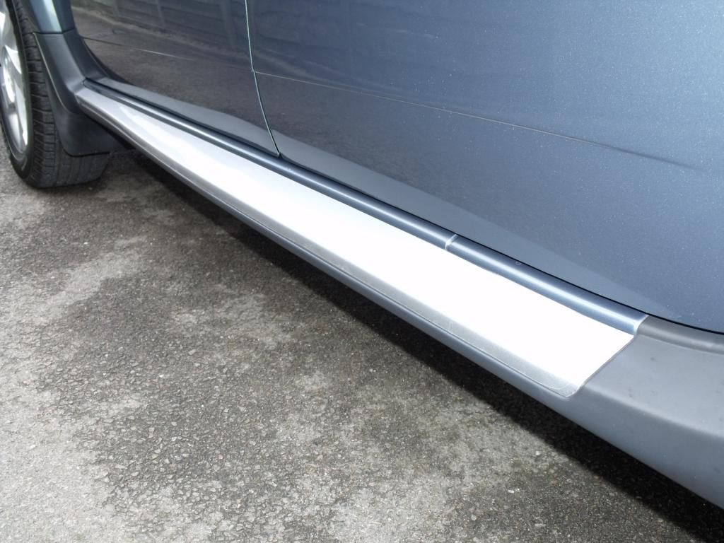

As suggested somewhere on another thread the silver plastic sill can be protected from dirt, scuffs, etc by applying clear plastic film. I ordered "E-Tech Transparent Protection Film" for about £15 from Ebay. There's plenty to do both sides.
I made a template using brown paper, then cut the film complete with backing paper to size using scissors. It's then just a matter of cleaning the sills with the wipes provided and applying the film. I used a micro-fibre cloth to smooth the film as it went on.
A Few photo's:

Lots like a good job Graham ... Mine actually never came with this detail so I was happy enough as mine is black and this the sill is better in black for mine. I remember you posting about this and I nearly bought this kit before I got my Duster but luckily I held off.
40 Posts
Good job! The silver sills are quite vulnerable to scratching as you step out of the Duster so it's either a case of remembering to lift your feet over the sills or fit protection as demonstrated by GrahamR.
